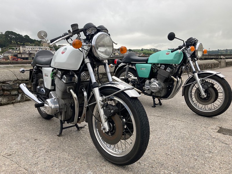

One of your best shots Jo, that is classic (y)
Im sure you will sort your 3c in no time.
how many ks did you do all up?
Cheers
Tom
Cheers
Tom
Thanks Tom,
in the Pyrenees we did something over 2000kms. With the 3c I did 14.000kms altogether since I got it in 2018, thereof 7.000kms since the engine revision.

Pyrenees on the splinter group BFN tour.(Jaca to Prades) 2019.Great shot Jo,hope you find your problem soon.
