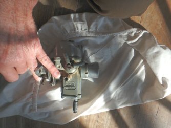

Had this same problem decades ago. I believe its leaking where my finger is. Took off the bowl. But the needle is free. Put it back together and is was ok for a few weeks then leaking again. I have a rebuild kit but thought I would post this before I rebuild. What should I look for??? Is there something in the ports? Or Is this a finished carb?
Most likely the rubber tipped fuel stop valve has failed.
Well, it is upside down! Most likely the needle and seat is worn. Even the tiniest bit of crap will hold them open and cause an overflow.

Ok the throttle needle is not center. But that has nothing to do w/ fuel flow. Above & to the right is the fuel intake port. It is brass. Don't see how it could be damaged on the inside. So my guess the carb is leaking because of the needle.

Your needle jet looks horribly corroded, good chance it's also pretty worn (out). Matter of course to replace both needle jet and needle, along with anything else that shows signs of corrosion. No point at all trying to adjust anything until the carbs are in half-decent internal condition. The carb leaks because the float valve sin't doing its' job. With the corrosion present, good chance the valve seat is knackered.
