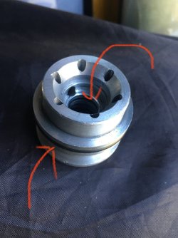

I have my (SFC 1000) M1R forks in bits and while changing the fork seals, I was looking at the seals inside the slider in the right hand fork leg,
there seems to be a few versions with slightly different parts diagrams,
I assumed that the O ring mentioned above was one of the the internal ones at the bottom of the stantion,
its about 42mm OD, but it probably aint!
Hi all,
It looks like I misunderstand this post,
I saw that the OP had leaking oil and didn’t realise it was referring to the m6 drain screw, I saw Piet said marzo have on o ring and assumed it meant the same 2x internal o rings I have been looking at replacing, see image, these are from right fork leg-M1R , and I can’t see the bigger of the 2 o rings on parts list, hence my question, sorry about that!
