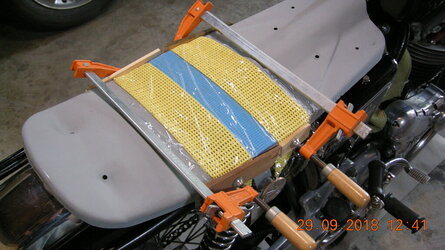

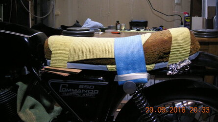

I'm not sure if this helps but moulding polyurathane (2 pack foam) is relatively easy and can be done just by enclosing in (virtually) any plastic, although polyethylene is best and then final shape with a rasp just like you would a surf-board .. similarly 'glass' where needed
as to foams .. I've found yoga mats are just about right (the ~ 3mm versions cut into appropriate sizes / strips) with a softer foam to finish it off
