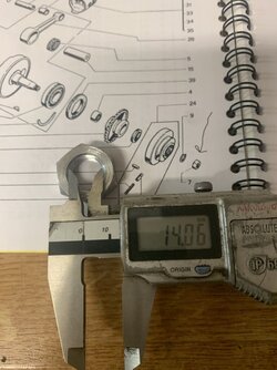

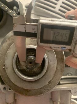

Nut starter freewheel left-hand-thread from Laverda Paradise does not fit my 750SF -73
Whats wrong here ?

On various crankshafts, I measure 15.97 mm diameter at the thread.
You need a 24 nut for the screw nut.
It looks like the (damaged) thread on your crankshaft has been turned off and a smaller one has been cut into it.
If this is a fine thread turning counterclockwise and the disc is correspondingly stronger, it should hold up.
Don't forget the spring ring.
Thomas aus LAU
Sees like I have to measure the thread and get a suitable nut made. :cry:
No Problem, Check if it is left-hand-thread or right-hand-thread and if it is a fine thread.
Here you will get nearly all scres and nuts: Wegertseder
If someone used a right-hand thread, I would secure the freewheel body and the nut with e.g. Loctite 638 or a very strong screw locking agent.
