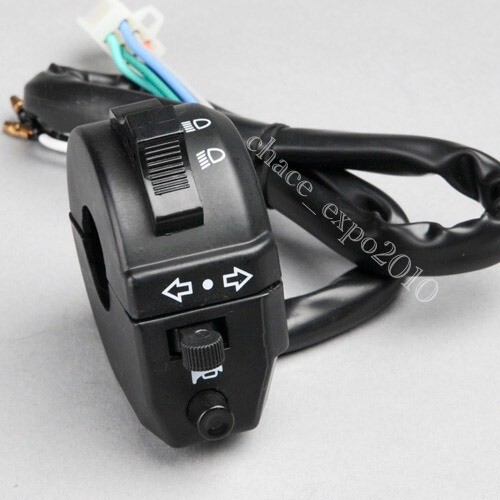

I didn't find much of a problem a few years ago when I was building a special. But I used a different switch configuration than the usual Laverda style. I bought a $9 switch from China for the left side (see below) that was surprisingly good for the price. Solid body and nice chunky contacts inside, but it didn't have the headlight on/off switch. Just the dip switch, horn and indicators. Probably made that way because many countries require the lights to be hard wired on. I used a separate toggle switch for lights on/off on my project. I don't remember where I put it, probably in the headlight shell (have sold the bike). Aftermarket switches with the same switch pattern as Laverda are available.
Your preference for the light switch to be away from the dipper sounds sensible. Everyone has their own preference and all sorts of switches are out there.
I've got a bunch of bikes and they're all bloody different. When I get on one I haven't ridden for a while, I have to re-familiarise myself where the switches are. I suppose it would make life easier if there was a standard that they all had to comply with. Maybe there is nowadays, I dunno.
Cheapo Chinee: e cum wi no headrie swish
Similar switch arrangement to Laverda
This Chinese switch would be a pain in the arse. You have to reach across the headlight on/off switch with your thumb to get to the dimmer switch. You'd be plunging yourself into darkness all the time.
