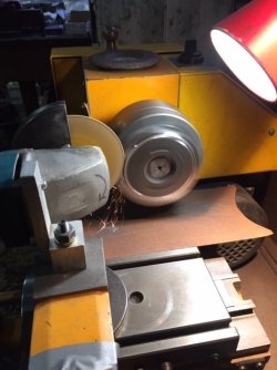

My Motodd runs 520. I use an alloy rear sprocket that I turned down in a lathe and the counter shaft sprocket I ground down using a lathe and angle grinder set up on the tool post. You can anneal the front sprocket, turn it down then re harden it but I prefer grinding them.

I'm running a 520 DID VX3 on my twin (which has a whole lot more power and torque than a stock twin). You can buy gearbox sprockets in 520 ready to fit (not sure who the suppliers are). I had a 530 in my parts bin and I sliced a sliver off it to get a 520 width using an angle grinder and cutoff wheel mounted in the cross slide of my lathe. Rear sprockets should also be available in 520. If you couldn't be bothered with sourcing 520, just fit a decent 530. I bought a blank in alu and drilled and machined it to fit my non-std (Triumph Legend 900) hub, but I'm sure you can source 520s and 530s to fit straight onto a stock hub.

Any it's not difficult to grind 530s down to 520 anyway.
It is far easier to just stick with buy and fit stuff if it is readily available, unless you are going for a major weight saving program or enjoy doing more work. Each of the engineering shops who trimmed down front sprockets for me said it was a prick of a job as the sprocket was ridiculously hard, in contrast to what Q says.

I tried machining the 530 with a carbide bit but it was indeed 'a prick of a job'. The angle grinder routine in the pic was not difficult. But probably not something an engineering shop would do! I'm happy to waste 45 minutes so i can fit a 520 that will last 30,000km.

The front twin/triple sprocket can easily be softened, machined and re-hardened. Makes the slimming down process a walk in the park.
