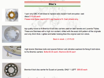

Here's the rotors offered by Paddy Ducati and at some point I'll weigh my rotors out of curiosity. In taking the wheels off for new tires, the weight of the front wheel is noticeable. By contrast the stainless Sunstar rotors on my Aprilias are very light.
