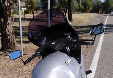

You can buy blanking plates, or could back in 2019. I ended up going back to fairing mounted mirrors, the bar-end ones made me too wide, especially when lane filtering.
I have the rectanglular RGS mirrors, but want to go back to using the California style mirrors. I bought some mirrors from eBay and have started making brackets, longer than the originals, hoping to see past my elbows better. I planned on making the brackets as long as the rubber boot would allow. Until I come up with rubber boot replacements though, the project is on hold.

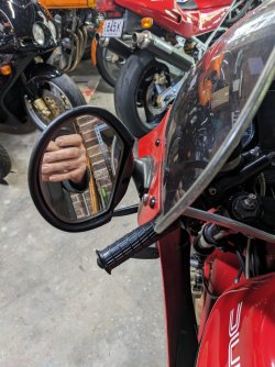

Anyone tried vitaloni Sebring mirrors, as opposed to the California ones? Do they work ok? The JDM fender ones looked cool, but broke up, too much vibration.

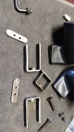

I’ve now been in touch with the rider, and Gijs van Dijk had made this for him. It’s more or less the same as what Alzero made.
I don’t have a milling machine to hand, so it’ll be old-fashioned filing.
First of all, I need to find a piece of aluminium.
I made mine with a bandsaw, belt and disc sanders and hand files.

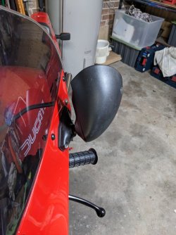

Vitaloni Sebring mirrors as fitted to MHR, will they work on the jota fairing?
