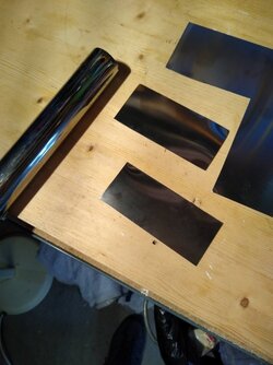

Mine was rattling and chuffing, so I sleeved the joints with a strip of 0.127mm 0.005”/ 5" Thou stainless steel shim stock. I bought a small sheet on fleabay and it tightened up the joint nicely..

I did consider tin can or a coke tin but could see the mix of metals corroding and welding up with exhaust heat and moisture so went with stainless just in case.
