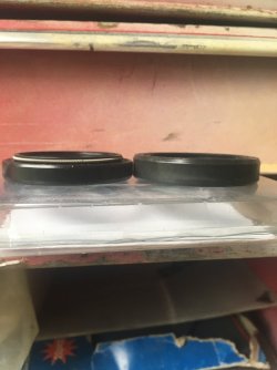

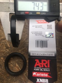

I am rebuilding my SFC 1000 forks and just putting the seals in when I noticed that the new seals are not the same height as the old seals, hadn’t noticed this until now,
I have had these seals for a while and didn’t think anything of it until comparing old v. new
So can these be used and if so what has anyone else done to make up the extra 2.5mm ? Or are taller (10mm) seals available, any reference number would be appreciated as anything I can find online looks to be like my new ones,
I tried a search but couldn’t get a definitive answer so thanks for any help,
Stuart
New seals : ARIETE ARI.083 41.7x55x7.5/10D889A618-7D8C-470C-8FCA-52C36F75C092.jpeg

The seals you have are correct. Don't worry about the 2.5mm, it does not matter and you don't need to add a spacer.
The Ceriani forks on earlier triples used two 7mm seals and the modern replacement is one 10mm seal.

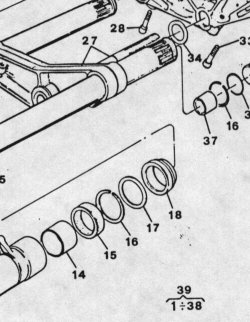

Ok thanks for the confirmation,
The parts list for sfc1000 does say 41.7x55x7 rather than 41.7x55x10 (currently fitted) that’s why I was unsure,
Plus no washer under the seal, only one above the snap ring,
