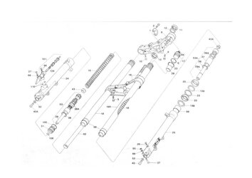

Having stripped the forks on my new to me 1000SFC we have found a bit of a mess and some missing bits.
We believe we are going to need
53, Rebound damper rod unit (RH)
56 Upper pilot boss
58 Lower pilot boss-
139 x2 Washer
37 Valve bushing (missing!)
38 Stop ring
38A Stop ring
Where in the UK would I be able to source these bits?
Or is there a better way and a recommended change I should make with different internals?
Or someone I should be giving these to, to rebuild?
Don't want to spend a fortune but want it to ride right
Thanks
Anyway it will not work well with the original parts. Best will be to contact Maxton if they could offer a conversion…..
Or look for a BMW K 1100 fork which will fit with some changes and work much better than the sticky M1R.
Forks will be going up to Maxtons next week. They were very busy with TT week so took a while to get to speak with someone. Be a few more weeks before I get to ride it. Thanks for the advice.
