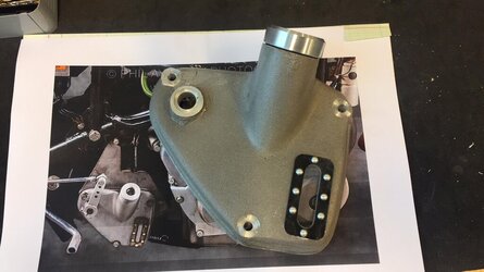

Magnesium effect surface.
...but don't use a ferrous blast media. That can promote corrosion due to surface contamination.
Some say that a quick rinse in acid will resolve this problem but I have no experience of that.
Please explain a little more.
Is that the color of the metal after blasting with no further treatment?
I have a cover that was heavily corroded from riding in the rain etc, I sanded and painted it silver to hide the corrosion. If it would come up like that with vapor blasting then that'll be the next treatment.
Else what is the treatment after blasting?
Peder and Lavermax talk about aluminium replica parts that they want to finish to look like magnesium. I bet yours is a magnesium one. All you need to do is blast it and wait, as it will turn grey again with time.

Depending on the composition of the magnesium base material, it may even get a slight golden sheen. All part of the natural oxidation process that forms a corrosion-proof layer over the surface. This won't stop aggresive chemicals such as road salt from attacking the magnesium, but general environmental influences should be harmless.
Alloy can be blasted and anodised to replicate the aged magnesium look. The selector cover in the pic is a factory magnesium original.
