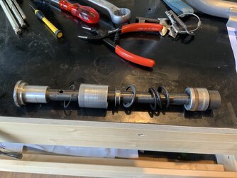

I am rebuilding the forks on my 1981 180 Jota. On disassembly left and right were assembled slightly differently, must have made an error in my last build about 25 years ago. So found this diagram, but it seems neither fork has item 37! C37BD1ED-FCA3-4A90-892F-0A9251B95959.jpeg
Is it an issue? And is this the right order of assembly?A457A3D1-666C-42AB-B858-546CC68D3C3C.jpeg
