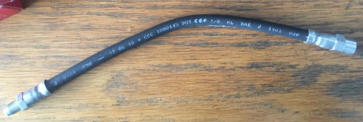

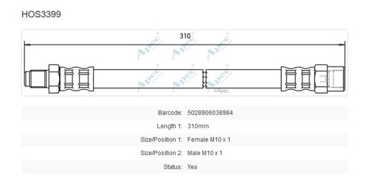

Check all unions and lines, especially the rubber hoses.
New ones can be got from Alfa or Mercedes suppliers.EBay listing.jpgHOS3399 specifications.jpgIMG_1827.JPG
