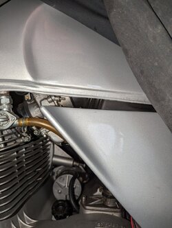

Yes. Been discussed many times here, Lothar - including by you!! You need to heat the airbox rubbers up in boiling water. They will then just about stretch on to the RS36. At the airbox end you will probably find you will have to push the rubbers further in than is usually the case.
Works even better with Red's angled stubs rather than the straight ones below :)
Indeed... as I said at the end of my post. The airbox rubbers fit just as well... but I can't find a clear photo of that installation for you!

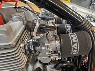

Sorry, but the stock intake rubbers and airbox *won't* work with Red's angled intakes and RS36s; the angles are all wrong. I looked at it from every possible method and spent way too much time trying, it just won't work. And I would have liked it to work. They work with the straight intakes you show in the photos, no problem.
Also, my stock internals RGS runs 135 mains as dictated by my AEM AFR gauge and 02 sensor, at around 18C at 100M elevation. Flat out it would give an AFR of around 11.8-12.8.
Ramair MV-015 filter pods per Keith's recommendation.
Pilot: 15 (gives you more adjustment range)
Stock needle 4th clip from top, washer under.

your custom cam cover stud is upside down
