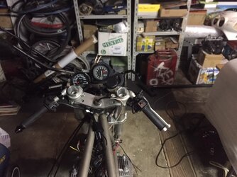

I think the throttle travel was very long with the Dell carbs, so when I put Mikuni RS on I wanted a quick action and put on this Spanish made Amal "very quick action" which works verywell. A little heavy, but with a Venhill cable it is ok even without push cable. As pic shows the starter button and ignition cut off are "homemade" but works ok too.

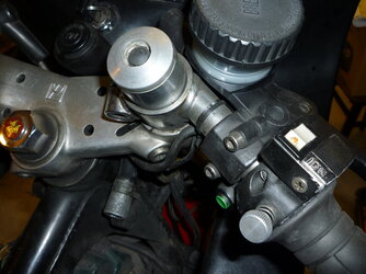

I bought a GT750 Right hand switch/throttle body unit from GTReiner. Same as the GT550 unit shown above. Looks identical to the original Laverda gear and works the cables for the Miks perfectly. All the switches work well.

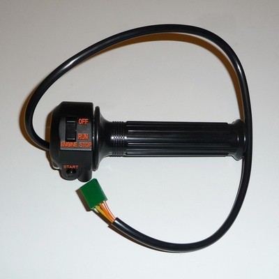

when I converted to Mikunis I found a used Suzuki GT750 throttle grip assembly in fleabay.
In case you are looking for a new one, GTReiner hasn’t any new ones anymore, but dutch dealer Knalnaarpotz (don't ask me what this means) still offers them – he deals mostly with 2-stroke stuff:
