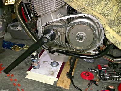

you will very likely need a new set of springs and bugger all else, easy job to strip the primary on a Mirage, no hassles at all, drain oil , loosen chain tensioner, undo bolts take cover off, (if it sticks get back to us,) undo the crankshaft jesus nut (locking tool required) unclip the circlip on the centre of the clutch drum, lift off engine sprocket and clutch chain wheel with chain in one unit, undo three clutch pressure plate bolts and change three springs then undo the other three and change the others, reverse order and you are done, new locking washer, and loctite for the jesus nut, tight as a circumcised person wearing a weird hat in a financial crisis, replace clip on clutch drum, new gasket on clean surfaces for the cover, re-adjust primary chain and finished.
If you really must take out all the spring bolts at the same time because you feel the need to inspect the plates, then getting them lined up again can be a PITA, a tool is available which makes life easy, but without it is still achievable just fiddly and frustrating!

those crank locking tools work great, but they are angular and not pleasant to look at or use, dont let that stop you buying one, they come without a socket, and you may well find that the ones you already posses do not have the correct outer diameter to work with the tool, not difficult to sort, but just warning you, and a six pointer is HUGELY preferable to a 12 pointer, that nut has to be tight! and if its easy to get off, take a look at the crankshaft splines for wear.
