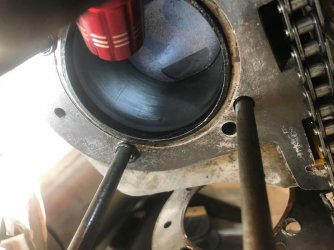

Meanwhile inspection of the bores shows some scoring so Im going to measure the bore and order new oversized pistons.
Any replacement piston advice would be appreciated?
