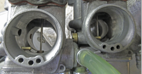

Good idea on checking the slides, but they are fully retracting at full throttle- the back portions of the slides are longer than the front, so they don't fully retract into the bores

This shows how the retracted slides look at both sides of the carb at full throttle- the slides are fully retracted upward when viewed from the air filter mount side, but hang down a bit on the manifold mounting side, and I can press the slide upwards w a finger to full retract. So is this correct or not?
If not, it may explain the weak engine response at higher speeds I've been trying to correct for a long time-

No it's not correct. The slides should completely clear the carb throats when viewed from either side when the throttle cables are pulled.

"and I can press the slide upwards w a finger to full retract"
One of the reasons I asked yesterday about cables and elbows etc. Sounds like your cables aren't retracting slides fully.
If for example you had incorrect length cables or installed elbows at the top of the carbs this would reduce pull available from standard cables so you would need longer cables. (well, that's what makes sense to me - I had thought about putting elbows at the top of my VHB's because of lack of room but didn't think they would work with standard cables)
Anyway likely it would act as a mechanical restrictor as you describe...............(no doubts others will confirm or debunk)
As mentioned they should 'disappear' at full throttle. Having said that, if you're struggling to get beyond 50-60mph on your 3/4 throttle I doubt this is related to the problem. Something to rectify but doubt it will resolve the issue.

I installed OEM carb cables w no elbows (it has the 1 into 2 splitter I'd like to change to separate cables), and since I can only see the slides from the air filter side once mounted, I never gave thought to how the other side of the slide compared, since I assumed it would be the same. So I'll see if I can get that side retracting fully into the bore.

the early PHF carb slides are different to the ones supplied today, a small amount of metal needs to be machined away from the (currently available) slides in order to work them in PHF carb bodies, If you had bought your slides from a reputable Laverda dealer, or a Dellorto expert (EG Paddy) then this would have been done for you, but as mentioned, the issue of the whole slide clearing the carb throat does need to be addressed, but I also doubt that this is affecting your current problem (of reluctance to go over 3,500/4,000RPM), the slide "hanging" in the carb throat might drop max revs 1,000 or so RPM (pure guesswork)
