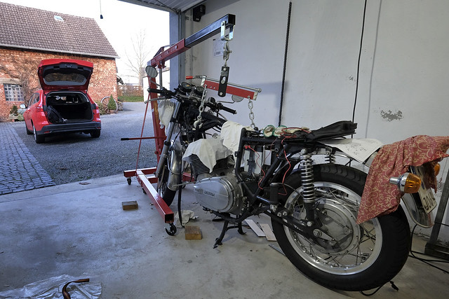

I used a workshop crane together with a leveller/balancer crossbar. With this it was possible to turn the motor out of the horizontal position and e.g. just lift it at the front. Was easy-peasy in the end!
