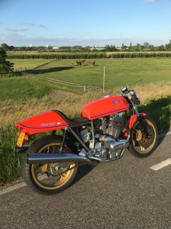

The CND850 was a very special creation that fascinated me from the very first time I saw it. I had the machine under my wings for several years and I was amazed by the incredible eye for detail. Photos couldn’t do it justice, only in the flesh it shows what a true marvel it is.
Those silencers were a work of art and when I removed them for the first time I expected them to be heavy lumps, but they were feather light! The tank was beautifully made and extremely light too. I could thoroughly enjoy looking at the front mudguard which has an exquisite shape.
The engine was such a violent shaker that I feared that on the long run, most of those beautiful components would suffer, crack, or worse. I did several attempts to improve it, to little or no avail. It was more a show bike than a riders bike and so I decided to let it go.
It was a privilege to have owned it though. If there is a Cloud Nine, I bet Bruce Hazelgrove can be found there.

Obviously a very talented guy to be building his own frames. Sadly we are losing a lot of the individuals who not only built bikes but knew what they were doing not to be replaced.
The CND looks amazing, a bit like the mid 70’s MV350 👍
