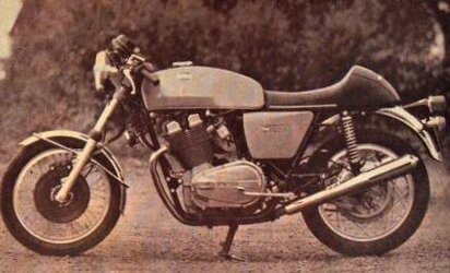

you forgot the 3CE, this truly was the for runner of the Jota
it was the 3C with wire wheels, 4C cams, H/C pistons, open exhaust,and SFC yolks, factory rear sets were on most, if not all. OK so it was a UK bike but easily identified as Slaters stamped an extra 3 digits onto the chassis number these being 3CE and stamped at an angle, sloping downwards crammed between LAV.1000/1 and the first star
You forgot the 3cE, this truly was the forerunner of the Jota.
It was the 3c which came with wire wheels. Slater fitted 4C cams, H/C pistons, open exhaust, optional SFC yokes, factory rear sets were on most, if not all. OK so it was a UK bike but easily identified as Slaters stamped an extra 3 digits onto the chassis number these being 3CE and stamped at an angle, sloping downwards crammed between LAV.1000/1 and the first star
OP didn't ask about them, nor Corsas, Clem.
Dave Minton's seminal 'The English Way' article 3cEDave Minton 'The English Way' Laverda 3cE.jpg (photograph attached), has the same rearsets as mine
