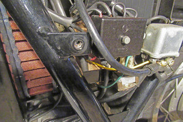

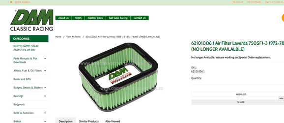

Thank you all for your input- today it seems to start better but is requiring the choke to maintain an idle, and not sure how long it takes to normally warm up before the choke is not needed. Removing the side cover shows the air filter covered in a red sort of crusty material, and not sure if that's normal (I think not) since I'm not familiar w/ the filters, but I'm assuming the filter should be lite green material or a reddish oiled K&N. DAM does not carry it and the K&N site shows a different design for the later 750 models. I also notice a corroded positive cable and a 2x4 (!) wedged in the take up the smaller newish battery. I'm sure I'll find more "surprises" as I examine the bike.

Pull out the old filter and throw it away. You can sort everything to get it running properly without the filter and get one later. It's just adding to potential problems.
Thanks I will do that- I've never seen a filter covered in dry red dirt- no wonder it won't idle! I think this bike was kept clean but not ridden much and I'll go over it all to check everything
Foam can dry out and become brittle and turn into dust. It can change colours doing that as well. All that takes time, sitting about for years does it. That dust can block jets really easily.
I think it's original filter and the material has begun to disintegrate and pulverise. Best chucked. No filter is fine while you sort other stuff.

You have got a later 750 model.
The engines are cold blooded and with properly set up carbs won't idle until properly warmed up, 5 minutes or so.

Well, here's the air filter that was broken as shown and appears to have never been changed. I can't see any light thru the material either. Since the "air filter system" is not exactly air tight and letting in dirt in various openings, and since the OEM filter is hard to acquire, I'm considering ditching the air box and installing individual pod filters onto the angled snorkels so they clear the frame. Have read mixed opinions about this. Also heard there's a way of trimming down automotive filters to fit the air box. Pirhana- for your method, did you insert pod filters inside the air box and into the snorkel ends, and why did you keep the air box- just curious. What have others done?
