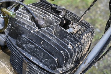

Dual condensers ( capacitors ) are just a reliability thing, similar to aero dual ignition- you wouldn’t want to lose an endurance race for the same of a condenser that can just give up. Twin plug two strokes ( DT400etc) had similar logic but you had to swap the cap over and hope the other plug worked.

Twin plug 2-strokes usually have a hot and cold plug fitted. Hot plug for start up and warming, cold plug for full-bore. Cap swap once the engine is thoroughly warmed. Exception is the Laverda Chott, true twin-plug ignition, 2 plugs of the same type.
In my experience, condensor capacity (? ;-) ) isn't really mega-important, as long as the points arcing is supressed. Laverda also fitted doubled condensors to the racing tiddlers back in the 1950's, they realised that losing a race due to a 10-cent part simply sucks. The stock item would be fitted at the coil, the "safety" was fitted outside the points housing (not enough space inside!).
