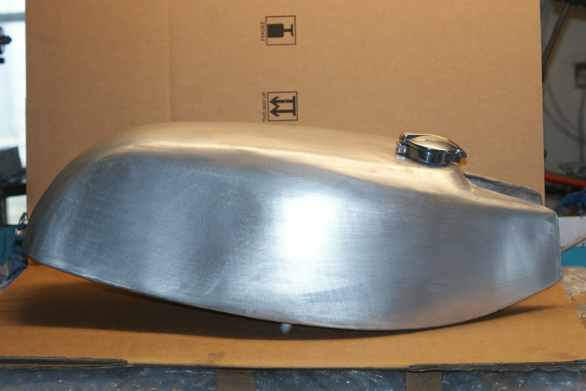

If original tank put it on the shelf & consider buying a repop glass tank or an alloy tank- here's a suggestion:
"If original tank put it on the shelf & consider buying a repop glass tank or an alloy tank- here's a suggestion:"
Been considering the same situation, not personal but....
Small issue of cost not to mention the hassle of importing into USA with the tbd depending upon when it may arrive tariffs and limited shipper choice options! And then there's the obviously incorrect filler cap.
I'm currently buying nothing from outside the USA except when carrying it back in my airline baggage. Loss of de minimis is catastrophic on small value items both to seller and buyer.
For the example: "Price excl. VAT: GBP 900.00" (today about USD 1300) - now add the tarriff - unknown, could be 15%, add USD 195, then there's the shipping and import duty processing fee (let's guess GBP 100 + USD 50) for close to USD 200, so we may be looking at USD 1695 total in today's poor USD exchange rate and tariffs situation - perhaps wait a while and see if things get better?
By comparison a trial of the epoxy liner looks like a bargain!
