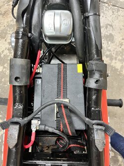

I wouldn't be riding the bike with the cables connected to the fuse block as per your photo. Shit happens - Murphy's 3rd and 12th Law of Relativity.
Expensive and damaging shit.

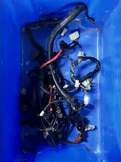

I have a complete wiring harness from a mid-1990s bike that I'm going to strip down and use to rewire the SF. It will provide me with everything I need: color-coded wires, a fuse box, indicator harness, starter relay, and instrument lights, among other components. This approach is much easier than creating my own wiring harness and color codes from scratch. Additionally, I plan to swap all the plugs for Deutsch Connectors to make the setup look more organized and aesthetically pleasing.

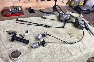

Next up is the carburetors! It's quite a mess, as I have both early and late series slides fitted, although thankfully they are both 50/1 so they somewhat functioned. However, the main needles are different—one is a K1 and the other a K2—so it seems like I'll need to strip these down for a thorough clean and refurbishment. Both slides were heavily soiled, scratched, worn and corroded inside, showing significant wear. I haven't yet disassembled the carbs to assess their condition and specifications, but at this point, I'm not optimistic about them being identical or in good shape.73372237632__09E13347-874D-47B5-8B70-D62DFC30E5FB.jpegIMG_2663.jpeg
Make sure your starter relay is rated high enough to cope with the amps drawn by a .95hp Nippon Denso starter motor! I found trying to get everything linked and still use multi pin connectors was too difficult. My new custom harness is a combo of old Sf blade blocks and multi-pin connectors. I want to be able to remove components easily. Sounds like you have a good plan - be interested to see the final product.
K2s only - no idea why anyone would put a K1 in with a std needle! Slides look serviceable from your photo - but hard to tell. You'd be surprised how forgiving they are, but if visibly missing metal, they will wear the carb bodies (= bad). Full ultrasound and replace anything that can wear or is important for sealing (fuel and air).

Sweet, I was going to check the draw from the starter before committing to a modern relay. My harness is so hacked about it's simpler to tear it all out an start again, although it all currently works....until it fails!

The slides have grooves in them and well worn. The needles have a corrosion ring around their shaft! So it's a full strip and rebuild. Thank god I'm familiar with these PHF's and have some spares from my Moto Guzzi rebuilds.IMG_2659.jpeg

I have a 74 750 and after replacing all the cables, I think dual throttle cables w/ o the cable splitter is a better design- and angled connectors to the carb tops will prevent the cables from jumping out of the carb top holders. Venhill can make any cable configuration and DAM Classic in Aus has parts. your slides look shot- especially if you can feel noticeable slop within the carb body. Mine were scored and new slides was an improvement, along w new needles and atomizers, all new gaskets. Check for correct float height and check gas amount coming from the pumps is equal. Buy a complete Dell Orto gasket rebuild kit. And make sure all passage ways are clear/ consider ultrasonic cleaning if really dirty internals.

I've checked the springs in the carbs, and they are both the lightest springs available, although one is 3mm shorter than the other. They both have the same wire diameter, number of turns, and it's only the free length that is different. So, they will be replaced with new springs.
I've looked at a set of 70-degree angled cable tops for the carbs and suspect that they will ensure a smoother transmission from the carb tops.
