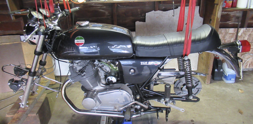

Sock- thanks for the tip on testing for a tube which I'll try. One tire installer claimed that radials don't fit tubes that well (not sure if true or not). For now I'm thinking keeping standard 100/110/90 and a bias ply Bridgestone BT 46. Would like to get tubes w/ angled valve stem if possible. Main goal is to replace these hard 8 yr old Shinkos that have no wear since the bike wasn't ridden by the seller-
Tyre fitters will gladly recite such fairy tales. Radial tyres can be fitted with tubes, no issues at all. We often haven't any options, not many dedicated tube-type tyres being made these days. Radials may not unleash their full potential if fitted with tubes, but I'd say that would be a secondary consideration with our clunkers, they're more than adequate. Radial tyres have soft sidewalls that help them do their magic, tubes will minimise that effect somewhat. The biased BTs also have quite soft sidewalls and display many characteristics of radials, probably what makes them so good.
Never seen angled valves in our wheel sizes, these are usually reserved for scooters and 16" Harley wheels. 90° angled valve adapters are available from bike accessory suppliers. These are meant for inflating/checking only and should not remain fitted while riding!
The BT46s are, in my opinion, a good choice. I'd suggest 110/90 front and rear, if on standard WM3 rims, straight valve tubes and buy one of these for easy inflation.
