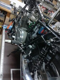

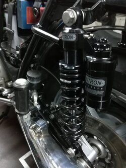

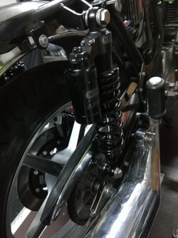

Fitted on my 3CL some months ago, furthest distance I have ridden though on a single run is only some 125 kms. The originals were just really tired with the rubber inserts breaking away from the eyelets. Fortunately I live in Austria so road surfaces are usually pretty good. As mentioned by Cosi - a lot of clicks to play around with - kept them as they arrived from NITRON as they were designed with my weight in mind. Only issue I found on fitting is that the right hand unit runs quite close to the chainguard, other than that an easy fit.
