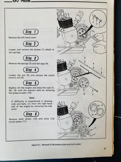

... sorry Red, no dimensions found! See yourself!
Best to ask Mark Kay - I am sure he knows the dimensions very well: https://www.mv-agusta.co.uk
Ciao, Gert

thanks Gert, those scanned pages are a great help
