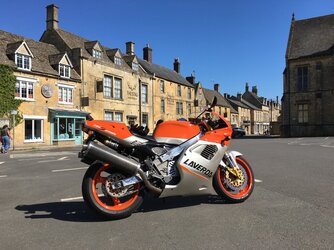

be very careful taking the plugs out2020-05-25 15.56.44.jpg - water has a tendency to collect and some have had the plug rust in and break
the main thing (imo) is to ride the thing if its running as its great fun - i was out yesterday and its a fun ride - brakes and steering are exceptional
It could go bang but i think as long as you don't track day it and watch the oil every mile is a winner - you can have the crank sorted BBU or ABU ( before and after blowup ) and the price of doing this depends on which one you go for - i have now done 2000km still good to go

It is my intention to get the bike fit for the road and use it when the weather permits. Yours is spectacular in the silver and orange, I thought my red one looked good! The blue and orange that has just been for sale is truly beautiful IMHO.
