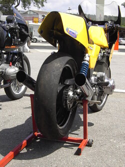

Hmm, why does it say 'Laverda' on the fairing of the twin-plugged BMW? :unsure:

"Special thanks to Laverda for....." forgot the rest.
I rigged up a Laverda BTZ ignition for it, worked well except for the enormous current drain. It was running constant loss on a 5Ah battery, so the Bosch BTZ was eventually replaced with an Ignitech, but still using the old Laverda/Bosch pick ups.
Nice and light, bugger flew like shit off a shovel!
