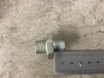

I need to ascertain the length of the adaptor thread that screws into the crankcase. (This is the adaptor that the oil cooler pipes attach to).
Thanks to an earlier post by Piet I know the thread sizes ('79 series 1) are M12 x1.5 and M14 x1.5

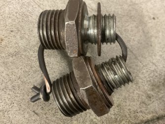

Bear in mind, Pat, that there should be copper crush washers or Dowty washers between the adaptor and crankcase.
Here’s a set I removed from 120 crankcases last week. I’d hazard a guess that your mate El Bodger hadn’t fitted the sealing washers.
