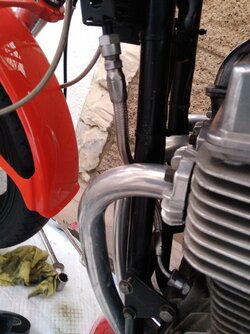

So after 36+ years of trouble-free use, one of the aftermarket braided SS oil cooler lines has a leak (see attached picture). Once the RPM reaches 2500 oil flow pours out of the connection where the curved tube connects to the braided hose. I originally bought these from Lance Weill aka 'Rickey Racer Laverda', Lance had a few sets made for his many projects. Does anyone have a source for a similar replacement?

You can unscrew those unions and replace the hose alone. Clamp the elbow in a vice and unscrew the hex part, the hose comes off with it. Generic 8mm/ 5/16" rubber oil hose fits nicely. I've used a Gates product, has held up fine for the past 12 years or so.
I avoid braided/sheathed stuff because ageing and/or damage isn't instantly visible.
If that hose is a crimp fit you could try a farm supply store [if they make hydraulic hoses], or a construction equipment dealer. They usually make and crimp lines as they lead a tough life on equipment. OR a good speed shop could sell you the fittings and hose to make your own.

Laverda used several different hose designs over the years, those pictured by jotadave are not crimped. Their design is very similar to that horrible looking blue and red Aeroquip stuff. Later models such as the SFC1000 or OR600 had crimped oil lines.

So I got my oil cooler lines expertly sorted at a local 'Hose and Couplings' shop. They used the existing "BLING" fittings and cleaned them up a bit, one day turn around and $55 bucks out the door, I am very happy. I hope to get another 30+ years outta this bit of "BLING". The ceramic coated exhaust headers and exhaust ring are more "BLING" with a purpose.😊
... unscrew those unions! Is that true? If so, a great bit of info. seeing as I was considering mounting a deeper oil cooler to the 1200 and would need new hoses. I'll give it a try (when it's not freezing in the garage.)
Of course it's true. I'll dig out a disassembled one and post a pic tonight.
I've been having them re-plated for ages, only problem is the nut on the cooler. The olive on the cooler tube needs to be cut to get it off.
