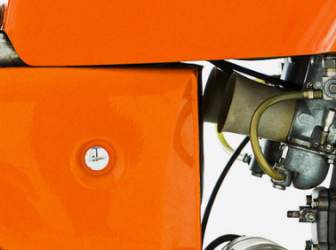

Ariete 8x13 fuel line on the pic below .. one year old
(FYI .. fuel tabs not original BTW .. inside diameter larger - for a better flow - than the standard Orlandi)

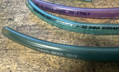

I bought some loverly green Cavis benz hose from a Fiat dealer a while ago, about 25 metres of it, just the ticket, it stays flexible after many years and green, but....... big but, the spare left on the reel in a dark indoor cupboard is now BLUE! what? how can that be???
In front is the original, then the new one that Bevel Heaven, Mdina and others are selling and the purple Ariete double lined is probably the best, but colour is nowhere near the original. It does fade though.
