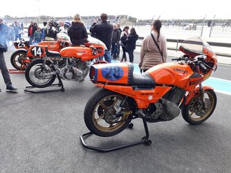

You can use just about any type of paddock stand with varying degrees of stability. I've tried the ubiquitous Chinese made item that has U-shaped channels to locate under the swingarm. Because there is no positive fore-aft location, these are prone to slipping.
Better is to fix bobbins to the rear lower shock bolts and use one of the Chinese made stands that locate on them with a rotating C-shaped fork. If you want to splash the cash then a decent alloy stand could be substituted!
My preference is the Laverda race team item that uses the footrests for stability and unrestricted access to the swingarm, wheel etc, but it takes up a lot of space. You can climb all over the bike when on this stand with impunity. 20180325_123844.jpg

@Rob looks great, do you know how/where to get one? thanks

I believe they are made by someone in Italy - but I don't know who. Sorry!.
