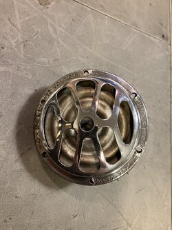

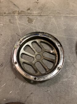

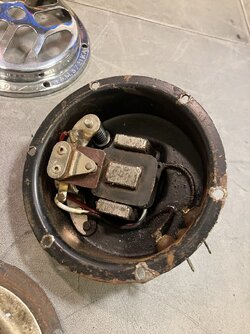

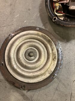

I just have to say I have resurrected mine 3 or 4 times, courtesy of a leasion from my friend Cam in Tassie. It was an annual event before I learned about the 2 drain holes that need to have one on the bottom or they fill up with water and rust internally. Both mine have the rivets replaced with nuts and bolts, I give the internal points a rub with wet and dry with them apart and adjust the exteranl Philips head screw slowly while holding the button down till it sounds. I start with the screw in pretty tight and slowly wind it out with the horn button pressed. Always a thrill when you save them again for another year.
HI have one for sale, need to be renovatet
