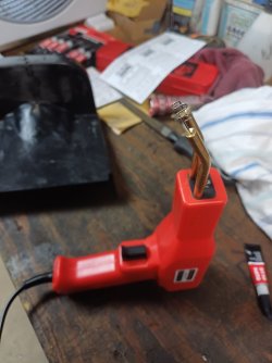

The wife orders heaps of stuff from Temu, I just shake my head and wander off. But once in a while.......bonus $12 AUD.
It works, after super glue-ing my inner duck tail back together I used the heat gun with the supplied metat bits, snapped the ends off ready to finish.
Comes with 4 different shaped metal bits.
Walla--- the bits hanging out in space will be covered by a plastic steel epoxy or similar.
I'm quite sure they ripped of someone, but for now thats all I got.
Beats doing it with a soldering iron. oh shit must be beer oçlock 🍻
Looks like an effective repair 👍
I wonder what the wire is? Nichrome?

Don't know what they are made of, but a magnet won't pick them up and they do bend but will snap of if you get it right.
Without doubt nichrome wire.
It a fantastic metal, seen a 650mm length get so hot, it was almost white, slumped down about 300mm from original horizontal position, and as it cooled went back to its original state, and still usable. But, once subjected to red hot or more, it does get rather brittle.
