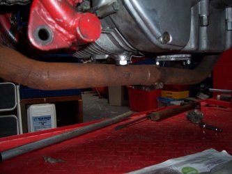

Never had the slightest problem with the idea of the plate and strainer system, but as mentioned the weakness around the stud holes, which the new replacements don't suffer as they are stronger billet alloy. Have also never had a problem with any leak there, the thinnest smidgen of sealant on the old gasket every time. I loosen it so it drains the oil, then hold it with needle nose pliers and remove it, no mess. I also have mounted a circular magnet in the bottom so that all the oil passes over it, it thus picks up whatever of iron based particles as well as stray cam chain links, gear springs etc etc. No more messy than modern bikes with filter change.
Ricardo Oro rarely takes the sump plug out of triples or the plate off from twins, he loosens the inner gearbox cover, then places a shaped aluminium plate over the frame rails on triples or suspended on twins and the oil gushes out. I am never sure why he uses this method, and have concerns for the gaskets, plus what about cleaning the sieve? but that is what he regularly does.
