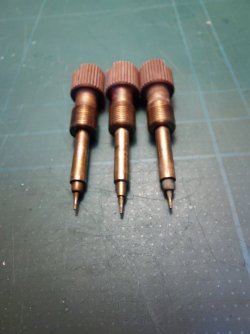

On closer inspection I've just noticed
The air fuel mixture jets are different.
1 odd one out, it measures o/a 36.2mm
The other 2 measure 35.3 and 35.5.
That’ll make all sorts of difference to your hang-up, which I was thinking must be an idle issue, rather than main jet.

Tips are broken off of the two outside mixture screws and are now jammed in the carb body
And they are a right pain in the butt to get out

Actually the tips are in tack. I can feel them come through the carb opening when screwing them in fully. Also have sprayed carb cleaner through them. I've also got a handy little tool I made for removing those tips. I managed to break one when I first installed. Very much aware not to over tighten them.
I just ordered 3 new ones and funnily enough they look different to both of the ones installed.
Those fuel/air screws measure middle one 36.5 o/a others 35.2 and 35.5.
I'm surprised I didn't pick them up when tuning. The bike has always run fantastic.
Just think how much better it's going to run now!!!
