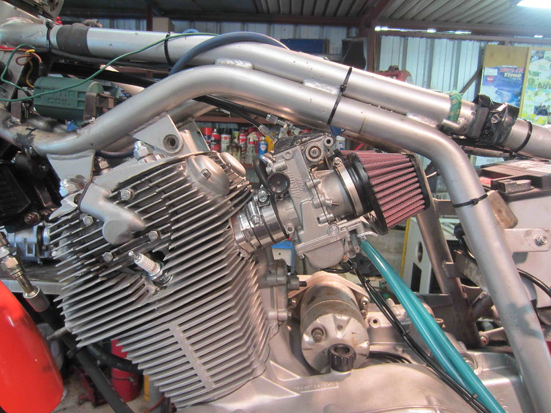

750 Mikuni conversion
Mis-matched cam end covers? Tut, tut, tut... ;)
was how the engine arrived in my workshop, you would have seen the same issue I am sure
Took me a few weeks to get the correct cam end covers but were installed before bike left here
