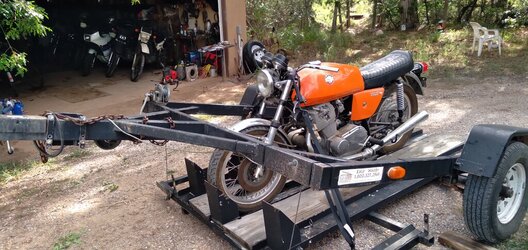

I just acquired a 1974 SF2. I owned a American Eagle 650 many years ago but generally ride Nortons and Velo's and a V-7 Sport guzzi. One of the first parts I will need is a set of points for the Laverda. I sanded them, but they are very hammered. I couldn't find a source on line. If anybody has any ideas I would appreciate it.. I am in Cedar Crest New Mexico. Brian Thanks
