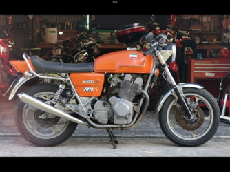

Hi have bought a laverda jota 1981 been sitting for over 10 years or so been recommissioned
One problem does not engage gear until really warm but when warm it runs fine etc no problem any thoughts dealer tells me it should come right just needs to be ridden as often as possible to bed clutch in again

are you saying that the clutch sticks and you get a crunch/lurch when engaging first gear?
Yes it won’t in gauge first gear it will make a crunch but when it gets warmer will go into gear but immediately stall then let it get a bit warmer it goes into gear fine then when you return from ride everything is working fine only happens when cold

Sounds like the plates have had it - I assume you have changed the oil ? Some oils can do this !
Your clutch is sticking. It's a Laverda. :)
I have exactly that problem with brand new clutch plates in my 3C. The clutch is less well lubed on that than your 81.
It can be oil related, you need to get the plates out, clean them in solvent and use an oil known not to give problems.
Otherwise, you do what I do. Keep a bit of inner tube in your pocket and use it to keep the clutch lever pulled in as soon as you stop for more than a few minutes.

Try contacting Redax in Australia, I believe they can supply kevlar clutch plates. I bough some from Keith Nairn in Scotland, certainly fixed my Jotas clutch, never had a problem with it again.

Could you recommend a type of oil would you leave the clutch pulled in for a week with Omer tube as only able to ride in weekends as of work commitments thanks

I leave the clutch pulled in all the time the bike is in the garage, no harm.
As for oil, I use Motul oils. No sticking clutch problems on my 750s or my wife's 500, but it sticks on this triple.

Not sure that on a hydraulic system, you should keep it standing with the clutch lever pulled for months. Never did that and never had to.
On bikes that I helped on or that I aquired that were standing for several years untouched, I did it like this:
if the clutch get's sticky, get yourself an engine cleaner from Louis, poor it into the oil, start the engine and warm the bike up. strap the front of the bike a bit down while it's on the center stand so that the rear wheel is lifting decently from the ground and can not touch the ground (best is a bike-lift with a removable plate for rear-wheel exchanges).
now put in first gear, rev a bit up, second gear and rev the bike to 2.000 revs (oil is warm assumed). hold the rev, pull the clutch lever and harschly step on the rear brake (just short time, not for long!).
after several attempts, it should break free. You should ride the bike for some kilometers with several gear changes, return and change the oil, please. If this does not separate the clutch and clean it enough, it's a clutch out and replace operation.
If it frees up when warm without that operation, you might just need to have the engine cleaner used for some kilometers and change the oil and you are good. If not, all you loose is 15€ or so for the engine cleaner and maybe 2 hours. Worth a try from my perspective.

I've had this problem on several Laverda's I've owned and found Motul 7100 synthetic 20-50 oil has additives in it that keep the clutch plates clean.
My RGS had this problem and after changing over to Motul the problem cleared itself after the first 3000 klm. Since changing the oil after the 3000 klm oil change I've never experienced this problem.
