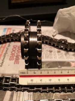

Not much interchangeability between twins and triples in the primary dept., front sprockets are spaced differently and clutch sprockets different tooth count. Gearbox mainshaft is shorter on the twins. Crankshaft tab washer, clutch drum thrust washers and circlip as well as the chain itself are shared.
For info' attached a pic' of crank sprocket.
I think that at some time a previous owner has used replaced the sprockets from a later 120, assuming the singles option was never used on the 180's?? Although an 81 bike the head has an 83 stamp and the carb inlets I believe are from a later 120
