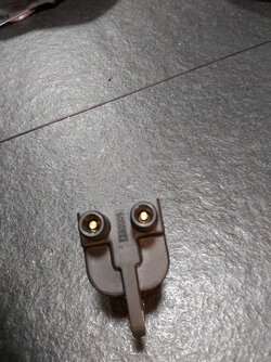

As recommended by Red, I have a set of PVL coils for my 3C rebuild. Same coils as the Nology but cheaper.
Apparently fitted to Hinckley Triumphs.
How does one attach the HT leads to these?

From the web it seems that coils should come complete with the connectors that you need to crimp to the HT leads - NOLOGY has a similar arrangement.
https://www.elektronik-sachse.de/sh...umph-ht-ignition-lead-terminal-for-pvl-coils/
