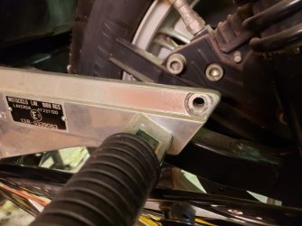

looking at Piet's photos, the mounting to the the back of the foot peg mount panel is a modification. On the actual "Executive" model (of which there were very few), there is a mounting point molded in. The quality of the bag frames is very high.
As a longtime owner of an Executive model, while the factory saddle bags are fairly stylish, they hold almost nothing. Pretty much useless for actual travel..... This fitting process you are going through is a style exercise, not a functional one. If the bike is going to be used for long-distance work, go to large Hepco Becker bags or similar. Hepco Becker also used to offer mounting brackets specific to the RGS, don't know if still available?
Personally, I put the factory bags on primarily for occasional display at bike shows. When travelling any distance for several days, I leave the factory bags off and hang a pair of substantial soft luggage over the passenger seat and hanging over the sides where the hard bags otherwise go, the factory bag mountings are handy mostly to keep the soft luggage off the rear wheel. Any decent tank bag will hold more than both Laverda factory hard bags combined. Style over function.
I will shoot a couple of photos of the mountings for you if the bikes owner remains determined. I would not bother myself if the goal is actual function and actual travel, if the goal is style, go for it.......
I agree that the bags are practically useless but seeing as they came with the bike he would like to be able to mount them.

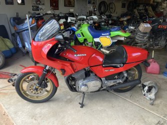

It happened! I finally rode this thing.
Let’s just say it doesn’t handle great on the dirt and gravel road on my driveway and the road to my house but once I got to pavement it came to life. I didn’t do a full ride but I did 18 miles of twisties and got up above 9000ft altitude and it was still pulling nicely. It was actually somewhat of a non event. It runs pretty nicely.
Here’s my 2 cents:
It’s a bit quicker than I expected. It doesn’t seem to like lower rpm but once you get it rolling and up over 5K it really smooths out and pulls well.
Just like most Euro bikes I’ve ridden 1st gear seems to high and it wants to shudder a bit until you get moving quicker in 1st. After that it’s smooth sailing. On the pipe it’s probably the smoothest triple I have ever ridden.
The seating position is nice but the windshield funnels the wind right into my face. I passed a few sport bikers coming down while I was going up and it certainly turned some heads.
Overall, I like it. I don’t think I could ride it all day like I can on my ZG1000 Concours and I don’t think it could hang with my ZG but it definitely gets more style points.
At this point I would like any information I can find about mounting hardware for these bags.

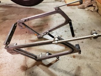

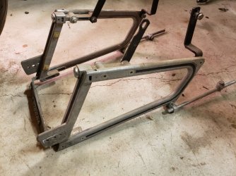

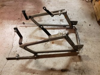

That would be great! I have the parts diagram and part number list thanks to Piet
but some pics of the mounted parts and a pic of all needed mounting parts would be very helpful.
And of course I am open to hearing from anyone who has the needed parts available for sale.

@Magoo - a few pics of the bracket assembly & additional hole location on the footpeg plate:
