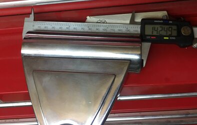

Hi all, a friend of mine is restoring LAVERDA 1000 *1178* and is missing the complete headlight support. No chance to find it. So we are looking for a 38mm version to adapt it to the 35mm forks. Can anybody confirm that the fork shrouds (headlight bracket support) of the 1000 drummer are the same length as on the 750 GTL?
1.) 1000 drum + Ceriani 35mm = 158mm
2.) 1000 disc + Ceriani 35mm = 147mm
3.) 1000 disc + Ceriani 38mm = 143 mm
4.) 1000/1200 + Marzocchi 38mm = 165mm
5.) 750 GTL + Ceriani 35mm = 158
6.) 750 GTL + Ceriani 38mm = ???
Ciao, Gert
Anybody out there with a 750 GTL to measure??? Ciao, Gert

143mm measured with a rule, on my "74 pre oil cooler big headlamp 3C 1580 Gert.
