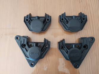

Re-Anodize Brembo Calipers
I had mine cerakoted. Lovely finish and about
€ 100 for the pair of calipers.
I did the front master cylinder as well.
anodizing old parts is real hit and miss when it comes to final finish, 98% of the time you will be very disappointed in the result
far better off getting them Cerakoted
The problem i have found is the modern way they pickle the calliper before re anodising seems to etch the zinc in the casting then once re anodised the finish is blotchy . Re anodising seems to work if they dont chemically strip them first but most do.
I had these re anodised but as has been said it can be very hit or missDSC_1535.JPG

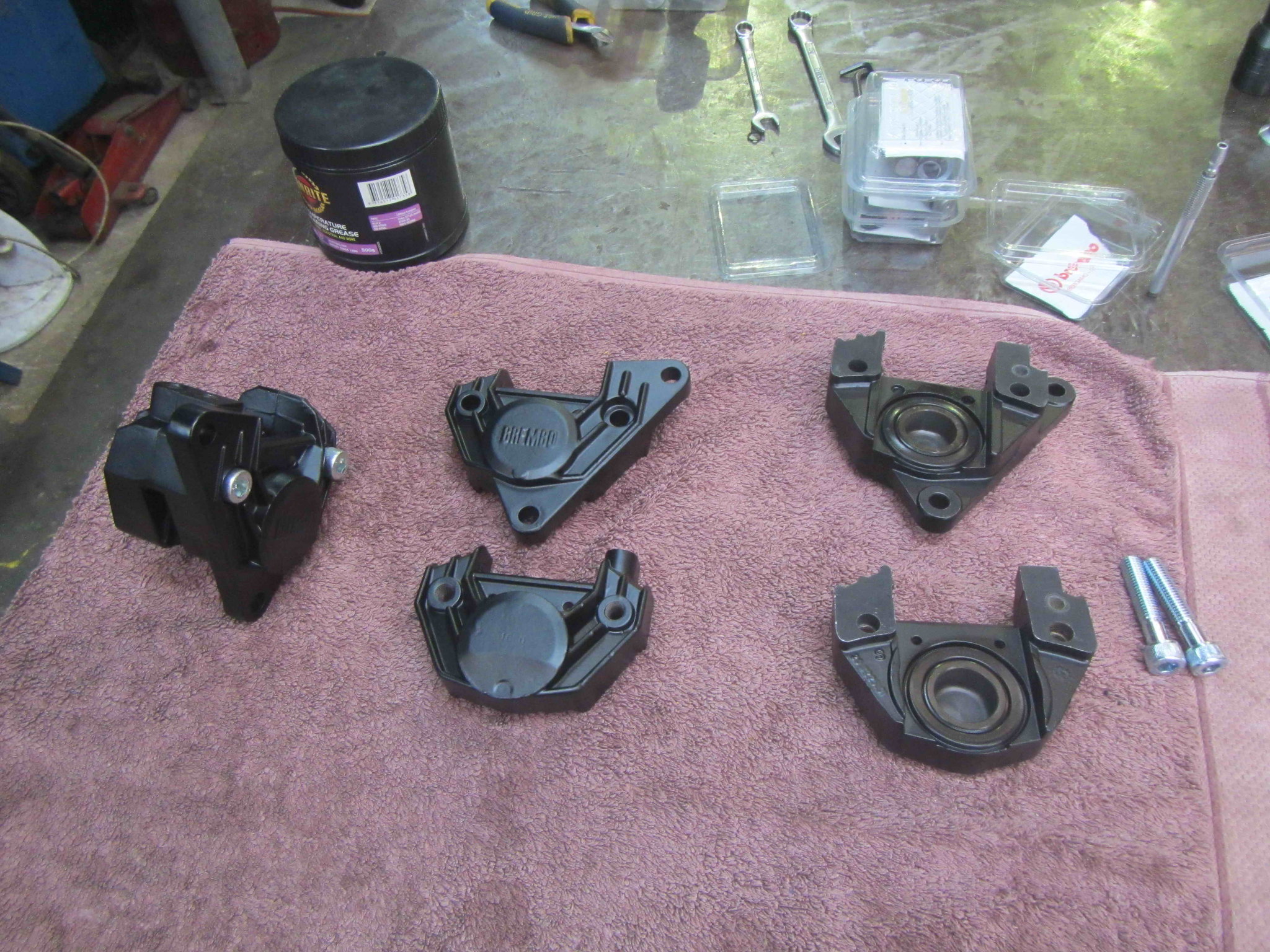

actually powder coating if done correctly works very well, we are very fortunate to have Roberto's Custom Powder in Brisbane, use him extensively when restoring bikes
these brake calipers are powder coated, he has formulated a black finish that mimics the original Brembo finish
prior to fitting new pistons, seals, bolts etc
