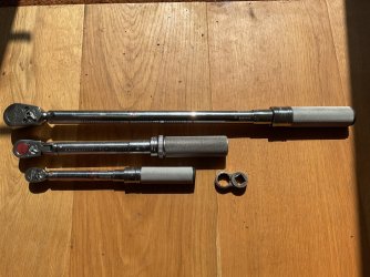

Goes well with my good old faithful torque wrench. 😀
in tool poker my royal flush beats your ace! I’ll be honest, I’ve only used the baby one on plastic tanks with threaded inserts . Big one for Ducati/ Honda / Triumph single sided swing arm rear axle and the middle one all the time. Stupid expensive but lovely.
