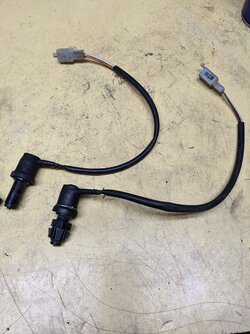

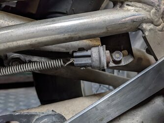

This is the original on my sf2, got a couple of Kawasaki ones on their way to sir Vincealot

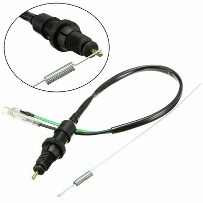

On a more sensible note ... These switches with the long tail on the spring are useful. Can be made to fit pretty much any mechanical brake. I wouldn't call it re-engineering, but you'll need to spend 10 minutes making up a bracket to fit it to your 3C.
